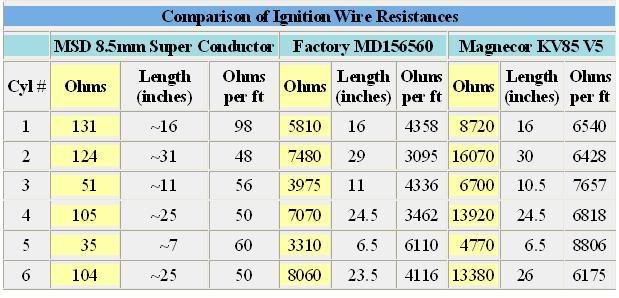

Stealthee
03-10-2007, 06:43 AM
I also found some time to change my plugs and wires. The magnecore wires are nice... I reccommend them:)
no no no Magnecores are WORSE than stock. The have the worst resistance of all wires available for 3s's.
X2Xtreme360
03-11-2007, 12:01 AM
really? I read that they're the most popular aftermarket wire for the 3s. I know popularity is another story, but I would imagine they would be popular because they're a good wire. Hmm, strange.
Stealthee
03-11-2007, 02:36 PM
The most popular are also the best. MSD's.
Linebckr49
03-12-2007, 04:40 PM
Stealthee is right. magnecores are worse than stock wires! don't be fooled by "populartiy" or what everyone else says, number speak louder than words: http://www.stealth316.com/2-msd-ignwires.htm
http://i57.photobucket.com/albums/g236/Linebckr49/3000GT/compIgnWireResistance.jpg
