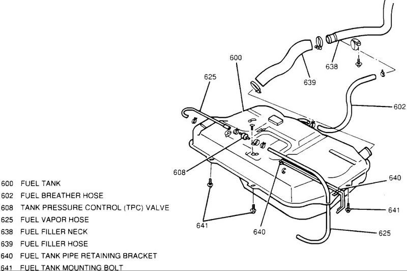

92 metro. Started leaking gas when full. It leaks out of the secondary tube that runs along side of the main fill tube. Tube has a little hole in it. The rubber coating that covers it has fallen apart and it is rusty. What is this tube for? Can I disconnect it? I see that I could take the hose off that comes from the tank and plug it. I could also plug the tube. Any thoughts.

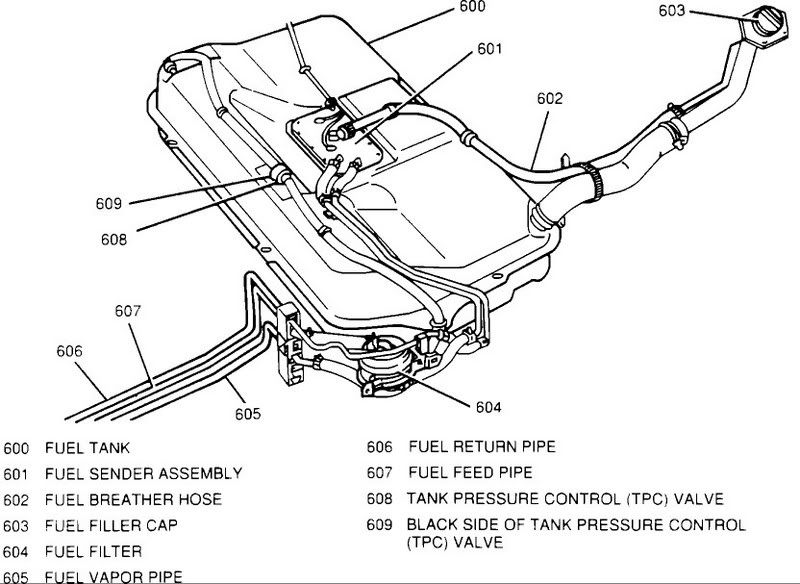

If i'm not mistaken, that tube is a breather hose for fuel vapor from the tank? Look at this pic...Is the Hose your asking about # 602 or part of the filler neck # 638? If it's the small metal tube that runs along side # 638......Your gonna need it! What I would do is: Disconnect the metal main filler tube and the rusted secondary tube from their rubber hoses, then remove the gas cap and take out the bolts that hold the filler tube assembly in place, remove the whole assembly from the car. Then get a "Gas Tank repair" Kit from autozone, advanced auto etc.... Clean the rust off the secondary pipe and all the dirt and grime off both pipes, follow the instructions and repair the secondary pipe with the repair kit. Reinstall the filler pipe(s) setup and all hoses. Then get a can of 3M spray undercoating from the auto store and spray it on the both metal filler tubes to prevent any further rusting in the future! Only other option is to find a "Non-Rusted" filler tube setup from a junkyard and replace yours with it.....Too bad though, I had a nice clean one a month ago but that Metro was stripped down and then off to the crushers it went.........:shakehead .
http://i25.photobucket.com/albums/c83/MrBBody/FuelTank.jpg
http://i25.photobucket.com/albums/c83/MrBBody/FuelTank2.jpg

Yeah it is part of the filler neck 638. Now I see what it is. Use is for when filling up lets air out of tank. I just happen to have a junker sitting out back that I can swipe it from. Thanks for the pictures.
