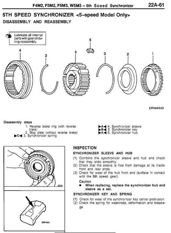

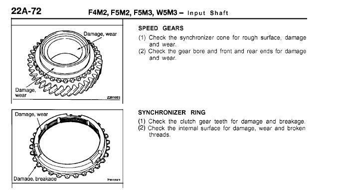

yes. the 'synchronizer' is actually an assembly of several parts. the blocking ring is the part in the synchro assembly that wears down over time. here is the 5th speed synchro assembly
the 'blocking ring' or 'synchronizer ring' is not visible in the photos of 5th gear in my transmission. it is below the synchronizer assembly. also, in the first diagram, the synchronizer ring is not pictured in the assembly, but rather in the second diagram beneath the synchronizer cone pic. the synchro ring fits around the synchro cone. the synchro keys engage the synchro ring. over time, the synchro ring wears down due to contact with the cone and keys.
