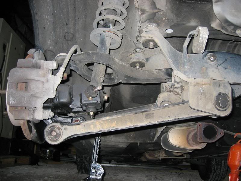

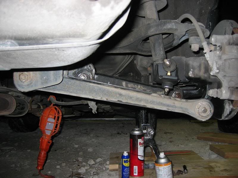

i'm confused, just as you are, how a faulty rear control arm would cause a vibration in the front.
not sure what rear controls arms he's talking about, but there are no bushings you can buy for the rear control arms. rather, they are made as one unit. however, you should be able to find some real cheap. i actually have all 4 that i removed from mine and replaced with adjustable rear control arms. not all mine are in usable condition (some were ruined when i removed them), but if you can tell me which control arms you need (camber or toe), i may be able to help you out.
here is a pic of all 4 rear control arms. 2 on each side. longer one (foreground) is the camber arm. smaller one behind it is the toe arm.
EDIT: upon inspection, there is also a 3rd rear control arm (the circular one) through which the rear strut goes. this is attached to the rear hub by what appears to be a ball joint. i've never heard of this control arm going bad, but that's not to say it never happens. again, let me know specifically which one(s) you need.
