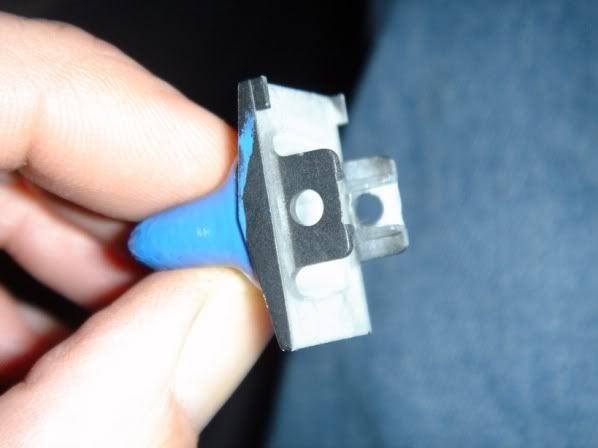

Here is the actual button taken off.
http://i28.photobucket.com/albums/c242/xeroinfinity/AUTOMOBILES/wndwbtn.jpg

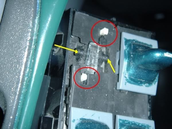

The yello arrows are where the button above snapped onto.
The red circles is the two switch pins that trigger the switch inside.

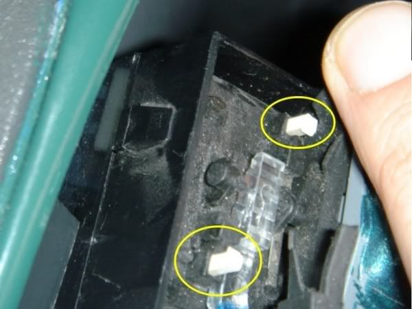

Window switch 1 (http://i28.photobucket.com/albums/c242/xeroinfinity/AUTOMOBILES/wndwswtch2.jpg)
The yello circles are under the rubber protector, and the white pins are the tiny microswitches.
Window switch 2 (http://i28.photobucket.com/albums/c242/xeroinfinity/AUTOMOBILES/wndwswtch3.jpg)
