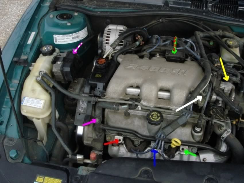

Just wondering if anyone had photos of their engines around 2000. I was noticing the car hasn't been getting up to temp in this cold weather. I let it warm up 15 minutes, drove 40 miles to work and you could still feel a little cool air coming from the floor. I just had a flush and fill done 3 weeks ago. I popped the hood and looked over at the reservoir and there was a line just laying there not connected to anything. It is the line right below the cap on the reservoir tank. The other two lines closer to the front of the car are hooked up OK. Just wondering if this line should be connected anywhere. I never noticed it before. Not sure why the car won't heat up like it used to. It always ran around 200 degrees. And man, my power steering is whining and moaning from the cold weather.

Pretty easy to bleed the cooling syst.
Run the car to get it good and warmed up.
Try and park the car so the pass front is up or at least level.
Turn on the heater full blast.
On the passside of the engine, above the water pump,
you will see a brass fitting on the reciculator tube.
Open the smaller bolt partially sna slowly.
The blot is hollow with two bleed holes so as its opened,
the air goes to the highest point. Was 1 good idea gm had.
heres a pic, purple arrow.
http://i28.photobucket.com/albums/c242/xeroinfinity/AUTOMOBILES/99gtundr2-1.jpg

Turns out the coolant was leaking, the thermostat was going south and the intake manifold gasket needed to be replaced....OUCH!
