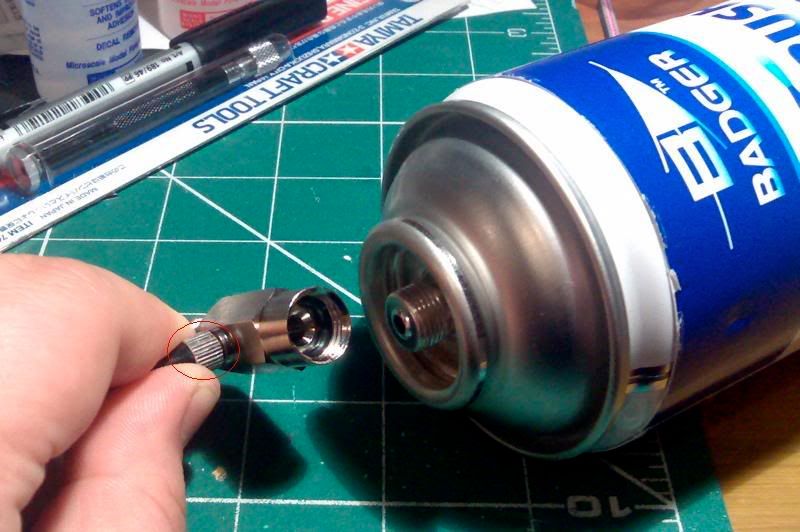

Hi guys,
Now I am back home, I thought I would take a photo of the 'fitment problem.'
http://farm1.static.flickr.com/156/377577253_4409fa514d_o.jpg
Any advice would be warmly received.
Kind regards,
BillyPee

stevenoble
02-02-2007, 12:42 PM
Bill,does the airhose unscrew at the part I have circled in red? If it does I think you could get away with just a can adaptor like Stupid_boy shows in his picture.The only thing it would depend on is if the thread on the end of the airhose is the same as the one on the can adaptor.The can adaptor would then fit the aircan you have and you could simply screw on your Tamiya airhose to this.

billypee
02-02-2007, 12:55 PM
Thanks Stupid Boy & Steve,
Yes, the hose unscrews from can adapter leaving a PS1/8 28 end.

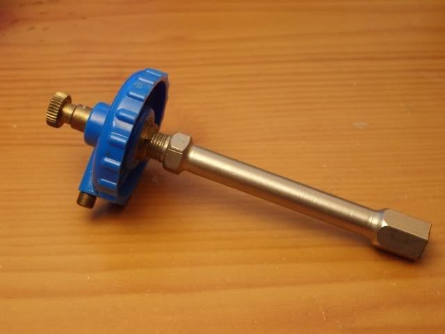

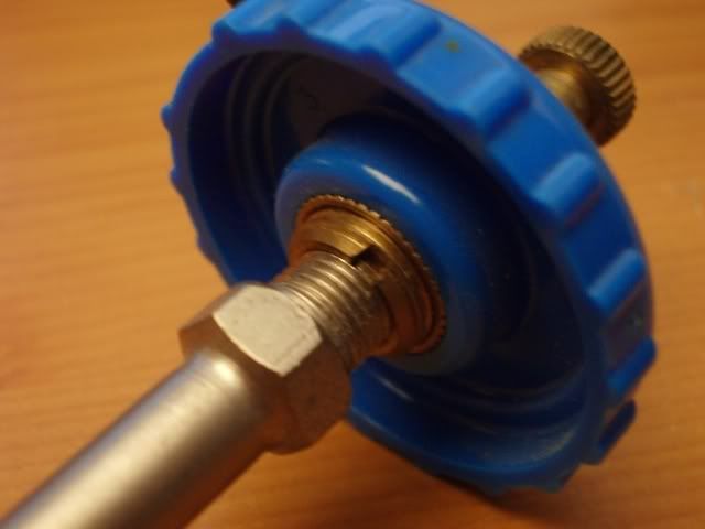

stevenoble
02-02-2007, 01:03 PM
Bill,I have just trawled through my model box and I have a Badger can adaptor.It also has a threaded insert in the bottom and a tyre adaptor (so you can connect it to any wheel from a real car and blow up the tyre and use the air from it to power your airbrush.See the pics below.It's yours if you want it? Free of charge.Send me your address via PM and I will post it off to you first thing in the morning.

billypee
02-05-2007, 11:11 AM
Hi guys. The problem is now solved. A big thank you to Steve for sending me his spare air regulator.
Now that I have both air regulators, it is easy to see the part I needed. The air regulator contains an air adjuster valve. On the one Steve has sent me this has a long thin male point to it which penetrates the female connector on the Badger Airbrush Propellant can. On the Tamiya air regulator, the air adjuster valve has a thick blunt male end which is clear designed to depress the top of the Japanese design cans.
The two air regulators that I have have different sized adjuster valve threads so they are not interchangable. However the hose adapter joints are the same so Steve's air regulator works with my hose.
