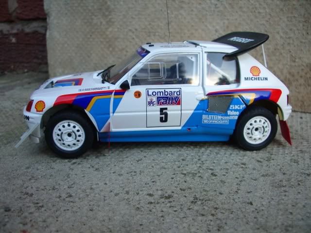

You will be able to produce a gold colour on the inkjet printer,but it won't be a true gold with metallic particles in it as the inkjet can't produce that.Also it can't do white either as someone already mentioned.I have done a few of my own decals with the inkjet printer and they turned out quite good.
The entire number board placard on my Peugeot 205 T16 was made on an inkjet printer.
http://i17.photobucket.com/albums/b61/stevenoble/Pug%20complete/IMGP1561.jpg
I have found that the clear paper seems to take the colours better than the white.But the white paper is essential if your image has any white in it.(unless it's going on a white background) The designs you can make are only limited by your imagination.You can make them from anything.A scan,image from the internet or design them yourself in a graphics program.
I always get my paper from here http://craftycomputerpaper.co.uk/ go to the left menu decal paper,inkjet.Clear or white available.I use Adobe Illustrator to design my own images and this works well.One thing you must do as already mentioned is seal the decals with acrylic varnish or they will bleed all the colour away when placed in water.Also the better your source image the better the finished decal will look.If you use a grainy image your decal will be grainy when you print it out.I don't think your Japanese artwork would be too difficult to produce.Hope this helps.

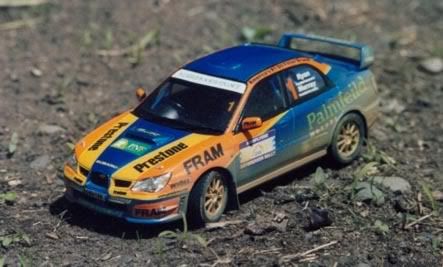

Hi James,
Another consideration for you.
I create my own graphics in Illustrator and print them at our Sign Writing shop with a GERBER EDGE printer. You may need to check in your yellow pages and do some ringing around to locate one, as with all things they have good points and bad points
PROS -
They can accept Ai, eps, CDR files,
They can UNDERPRINT white under another colour - ie yellow over white remains solid yellow.
I have had printed graphics 1.5mm high and still read it!
CONS -
They are printed onto clear self adheasive vinyl, not as thin as waterslide decal and not as flexible to use, can be pushed into body seams etc but does leave a more visable outline.
Colours used are SPOT colours (not CMYK) so may be restrictive to exact colour choices.
Registration can sometimes be a problem, especially when overprinting as sometimes a small amount of white can be visable.
Depending on sign shops, it can be expensive.
Hope this info helps
http://i160.photobucket.com/albums/t161/Kelcat0/FRAMScoobie.jpg
PROS -
CONS -
