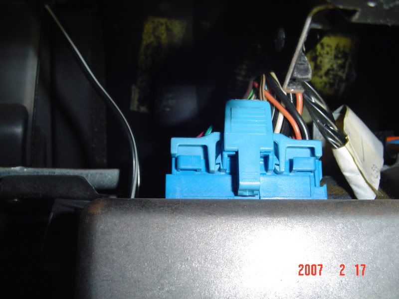

Heres the culprit. This stupid plug was not pushed all the way. WTF??? Ive had this truck for 55k miles and never touched that thing, how does it come part way out when there is a positive locking connector?
http://i63.photobucket.com/albums/h126/JoulesWinfield/Stabilizer/DSC02479.jpg
So after all that BS it was just a connector. At least its fixed.

I would say the connector was never snapped in real good and road jar just worked it back off.
