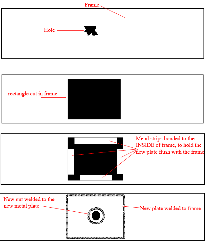

I think he's saying that the nut that was welded to the frame broke off and when it broke, it didn't break the weld, it actually took a chunk of the frame with it.
Here's what I would do. Make a rectangle template and mark where the hole was, and trace the pattern of the template onto the frame. Cut a flat piece of steel the same size as the frame, drill the hole for the nut and weld a new nut onto it. Then cut the frame where you traced the lines. Use some epoxy to secure strips of metal along the edges of the cut, on the INSIDE of the frame. That will make it easier to make sure the new piece of metal will lay flat and flush against the frame. And then weld in that new piece. Then spray it with some kind of paint so it doesn't rust on you.
http://img.photobucket.com/albums/v473/CivicSpoon/frame.gif

ah. i just kidna thought about that after a while. well hoenstly theres your anwser. right up yonder. but honestly it works pretty well. you got a hoel after words to spray your sealant into so it doesnt jsut out.
