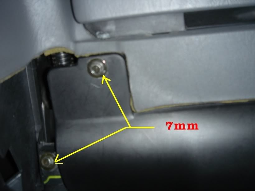

- Remove the lower kick panel on the passenger side floor board.
- Three 7 mm screws hold it on.
- Here is a pic of that (http://i28.photobucket.com/albums/c242/xeroinfinity/SeCond%20Hand/passkickpanel2.jpg).
- lower kick panel (http://i28.photobucket.com/albums/c242/xeroinfinity/SeCond%20Hand/passkickpanel1.jpg)

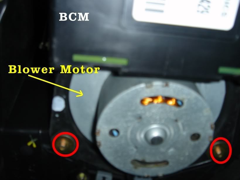

- Three 7 mm bolts(circled in red) hold blower motor in place (http://i28.photobucket.com/albums/c242/xeroinfinity/SeCond%20Hand/blowermotor1.jpg)too.

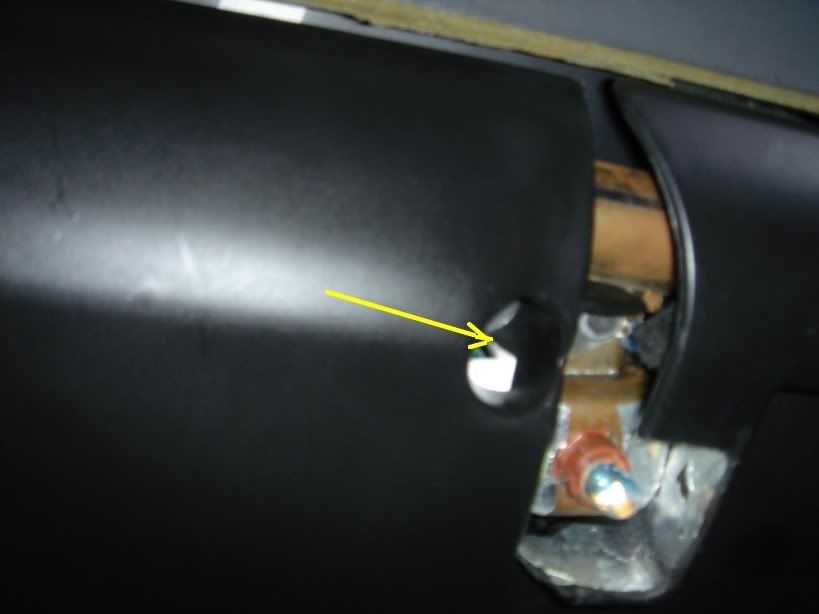

- Here is a pic of the resistor plug area (http://i28.photobucket.com/albums/c242/xeroinfinity/SeCond%20Hand/resisitor22.jpg).
- Unplug before attempting to remove.
- Remove the Two 7 mm bolts holding resistor in place(circled in red).
- swivle comes in handy here-
- Pull resistor straight down to remove.
