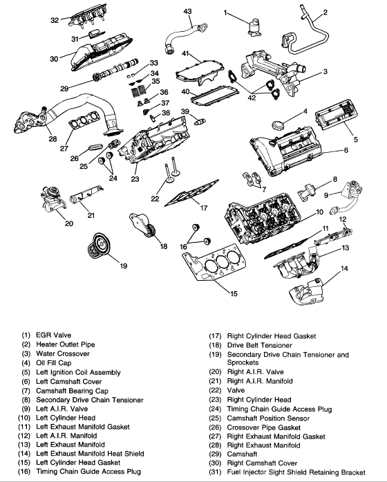

http://i41.photobucket.com/albums/e277/liquid100percent/86405357.gif
it's that water crossover #3 and gaskets #42. Try the bars leaks (sealer) and maybe you have some lose bolts on the unit. Good time to change out the Dex-Cool to universal coolant.

#42 is the water cross-over gasket

I could not find the part on GMpartsdirect. I believe the above, from RockAuto, is the part. I would goto your GM dealer make sure you get the correct part. NAPA will probably have it also. Fel-Pro is one of the best gasket makers.
Post the GM part# here.
