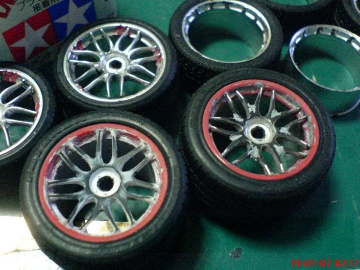

Gamerxz
01-18-2007, 03:38 AM
I have been working on this all day and this is what i got. Progress will be on my FXX thread.
I think if i find someone whose good at casting ill pass him my set as master to cast
http://i146.photobucket.com/albums/r266/gamerxz3/DSC01286.jpg
thats where im now...

Gamerxz
01-18-2007, 12:20 PM
Ok small update : Cleaned up alot of on the rims and 2nd rear rim is taking shape as well... Ill try to get hold on a resin casting kit to cast afew sets.
http://i146.photobucket.com/albums/r266/gamerxz3/DSC01291.jpg

Gamerxz
01-19-2007, 05:17 AM
U saw the progress on my FXX thread right? I used the stock enzo rims and added the ferrari style BBS spokes to it. Shaped it and there u have it... Still have alot alot of cleaning up to do but its almost there

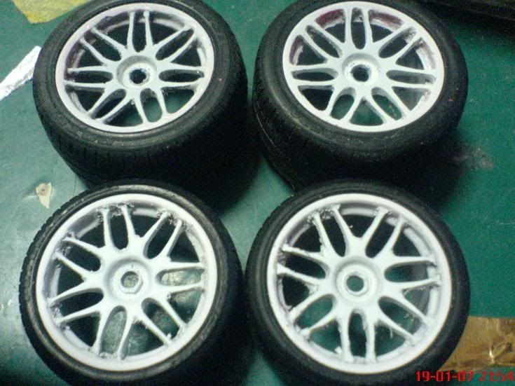

Gamerxz
01-19-2007, 08:31 AM
Rims at this stage
http://i146.photobucket.com/albums/r266/gamerxz3/DSC01294.jpg
Anyone up for casting them? i wont be able to get a resin casting kit till mar as stock has ran out
