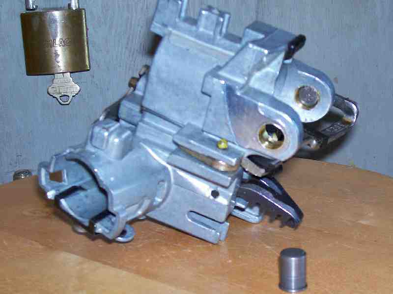

Look for loose joints here (where the naval bronze sleeves have been installed):
http://www.wwdsltd.com/files/YokePivotPinsBushed.jpg

Blue Bowtie - what part am I looking at here? I don't recognize it.

That is an upper steering column housing, similar to your's. With the steering wheel and plastic shrouds surrounding the column removed, you will see that piece. They typically wear at the pivot points, and the wear is almost always in the die cast column rather than the harder steel pivot pins. There is an equal chance that the screws attaching the lower column to the jacket tube have worked loose, depending upon the type of column.
If you can detect play in only the vertical plane, the problem may be with the tilt lock rack gears. If there is play in all directions, you will more likely find the tilt joint loose.
