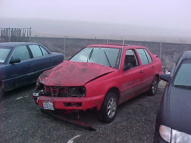

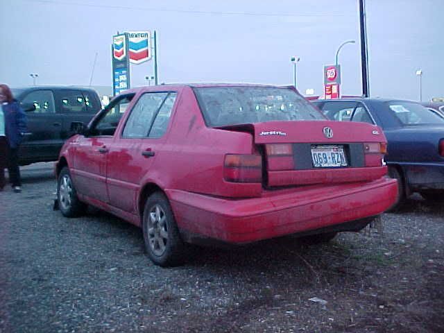

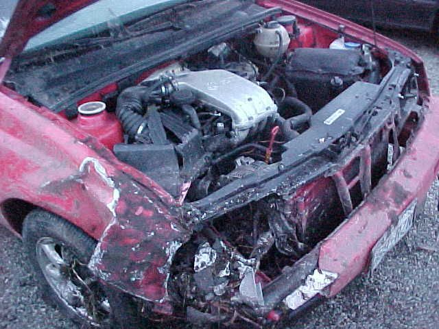

After what I did not long ago, it'll be pointless to post about this car. I was driving home, in dense fog, and in the middle of a curve, like an idiot I decided to look down for a second, and when I looked up, all I saw was a ditch. It was too late to pull out of it, and I slid into a raised part of the ditch, where you can drive into the field and whatnot, and flipped my car through a fence. I pretty much totalled it, so it's going to the junkyard tomorrow. Surprisingly, I walked away with little more than a small cut on my head, and a bruised thumb. I'll try to post pics tomorrow.
