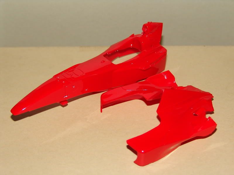

I've just started this Tamiya F2000. Just 3 simple coats of Tamiya Bright Red and some polishing with Tamiya fine rubbing compound. I need to do the panel lines, clearcoat and re polish.
This is a friends kit. My next kit will be my own for a change!:grinyes:

Thanks! I'm trying panel lines for the first time and I'm a bit nervous. What's the best way? There are many tiny grooves on the body that need darkening.

All you need to do is paste the link into the post and put at the start and at the finish.Put your link between the two and the image will show up in the post like I have done above with your link.You can even copy the image link straight from Photobucket and it does the above for you.Hope this helps you out.Nice paintjob by the way.You can use some enamel paint on the panel lines.Black might be a bit much.Try a slightly darker colour than the TS-49 it can look good on red.

Thanks Steve for the paint tip. Do I mask off or just use a tiny brush and a really steady hand?
Dave, this one will be OOB as my mate will keep it closed up. I'm glad you will be watching, but I'm pretty amateur at building too so I'm still learning and really nervous!

Use a very thin pointed brush.Thin the paint so it is quite thin,this will allow it to run into the panel lines easier.I always use enamel paint for this as it takes longer to dry so you get more control.Flow the thinned paint into the line and allow it to dry for about 30-45 mins.If you get any paint outside the lines don't panic.Let it dry and use a cotton bud/Q-tip very slightly moistened with thinner.You can use this as a sort of eraser to remove the excess paint from outside the line and you should end up with a very neat line.It takes a bit of practice,but it looks good when done right.

As Steve says, use a brown or deep red brown wash to highlight the panel lines, black will be too stark the brown will look more natural.

artists' oil paint (in the tube, available at art supply stores; available in a zillion colors) thinned with odorless turpentine also works well. here's (http://www.automotiveforums.com/vbulletin/showthread.php?t=441493) a good tutorial by MPWR.
