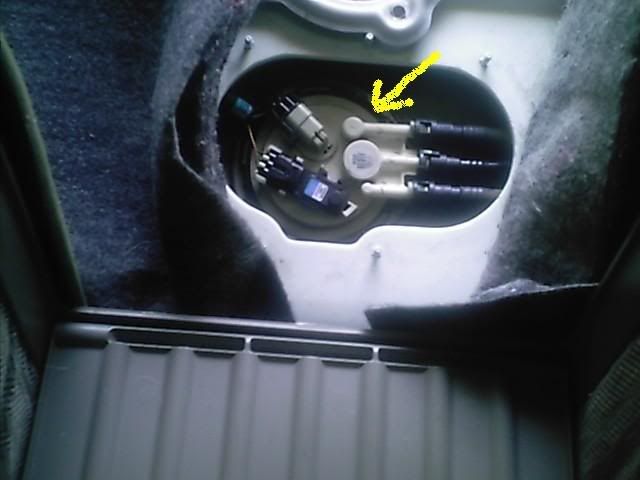

Are quick disconnect tools required to remove the hoses from the pump? Any hints about how to get the pump loose and out of the hole?
BNaylor
01-10-2007, 04:54 PM
Nope! All you need is a thin bladed flat blade screwdriver to remove the big c-clip retaining ring. The quick disconnects have two prongs that you press in on just like the connectors at the fuel filter. Remove the two outer lines first - fuel pressure and return. Then do the center connection which is for evaporative emissions. Undo both electrical connectors. After c-clip is removed, then grab hold of top of fuel pump and pull up. It will pop up an inch or two because it is spring loaded. Carefully remove the fuel pump assembly up and out, sort of snaking it. Don't tilt it after removal because fuel will be in there. Use plenty of rags around the area and I recommend vacuuming the top of the fuel pump area before removal to get the dirt out and none drops in the gas tank opening. Once pump is removed make sure the big o-ring seal is good. I use Vaseline on the seal during re-install. The seal is very important so no evaporative emissions faults occur later. Also, make sure battery negative cable is disconnected before starting any work back there. Good luck!
http://i5.photobucket.com/albums/y186/lizzywiz/fuelpump_top_clip.jpg
Arrow points to the C-Clip Retainer

You're welcome Wally. You must have the early model 97 which does not have the fuel tank pressure sensor integral to the pump unit so there is only one connector which is for the fuel pump and level sending unit (all in one connector). The evaporative emissions systems differ. '97.5 models and up have two. Yeah that is amazing how dirty it gets back there.
BTW - When you install the pump make sure it is centered just right over the hole and press down to load the springs before installing the c-clip. If the c-clip is hard to install it will be because the unit is not centered just right. Silicone lube or Vaseline on the o-ring seal helps too. Good luck and sounds like it is in good hands. :thumbsup:
