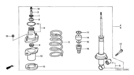

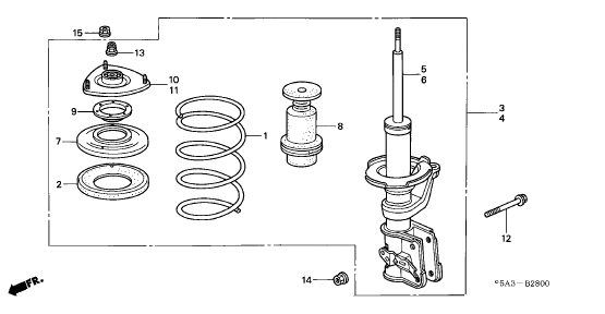

As long as you have a spring compressor its no issue. Many people will vouch for the 01 as having the worst suspension set up. Alot of issues with this year it was just put together poorly by Honda, and they have addressed the issue. As far as price I am not going to be much help there I am not sure of the prices. I went full coil overs for about a grand but my ride quality suffered greatly. I'd advise checking the upper mount assembly in the front as it is the part that usually goes on the 01 because it is rubber. I put up some pics here that I found here with some usefull information LINK (http://www.civicforums.com/forums/44-suspension-performance/237336-new-shocks-struts-what-reuse-vs-replace-update.html?highlight=replace+struts)
Fronts -
http://img.photobucket.com/albums/v712/beastiek2/13s5p0_b28.gif
Rear -
http://img.photobucket.com/albums/v712/beastiek2/13s5p0_b30.gif
