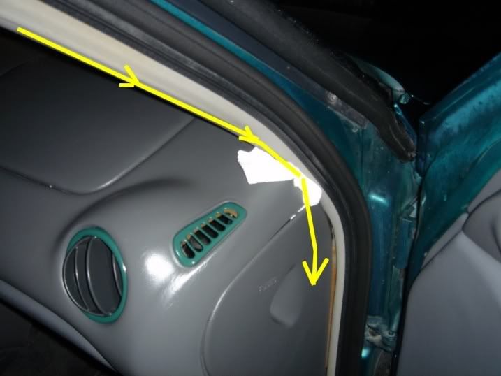

I trick I did to find out if it was leaking was to put a paper towel, kinda rolled up, in the corner of the dash so if water runs down it would get wet and keep some of the water from getting on the fuse box.
Here are a couple pics of two areas that leaked on my GT.
Yello Arrow ( http://i28.photobucket.com/albums/c242/xeroinfinity/11X17RW24/leaker1.jpg)is the path the water took down the pillar trim piece.

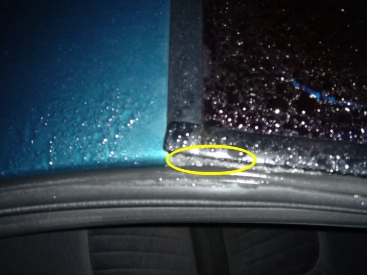

The Yello Circle (http://i28.photobucket.com/albums/c242/xeroinfinity/11X17RW24/leaker2.jpg )is anther spot that had a gap in the gasket for the windshield.

With the towel in there if it leaks it would get wet,
a cheap way to see if it does get wet on that area.
