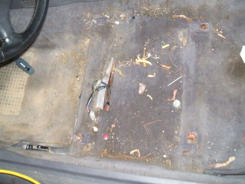

Step one take out front seat
http://i83.photobucket.com/albums/j294/steviekallday/2007_0103Image0008.jpg
as you can see I had an assortment of trinkets, french fries and yup even a couple bucks worth of change (don't get too excited thats in canadian dollars)

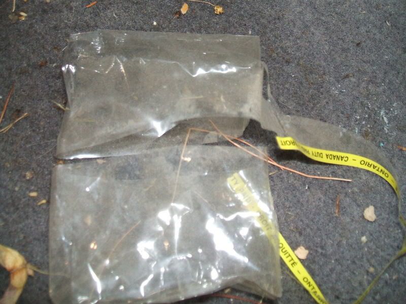

Step 2 pull back carpet
http://i83.photobucket.com/albums/j294/steviekallday/2007_0103Image0009.jpg
your right that doesn't look like the carpet is pulled back.. Thats cause I stopped in amazement when I pulled it back a little bit only to find a perfectly intact cigarette pack wrapper neatly installed. Probably installed right there on the assembly line. I can just see the bastard with a cigarette in his lips intalling my carpet thinking no one will ever find this.

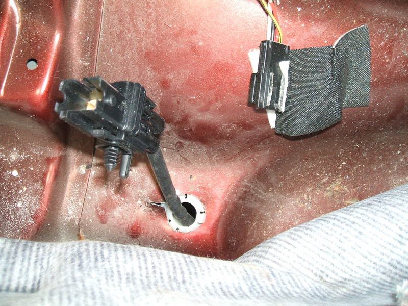

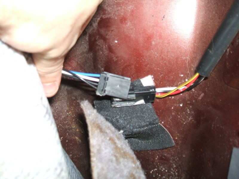

Step 3 Locate o2 wire
http://i83.photobucket.com/albums/j294/steviekallday/2007_0103Image0010.jpg

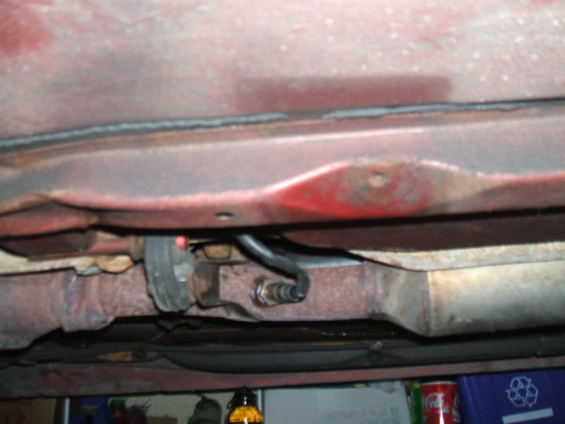

|Step 4 remove Old o2 (man this step is a bitch)
http://i83.photobucket.com/albums/j294/steviekallday/2007_0103Image0011.jpg

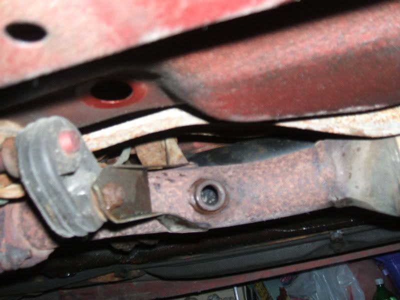

Step 5 Insert Wideband o2 in hole and put other end through bigger hole which you helped make
http://i83.photobucket.com/albums/j294/steviekallday/2007_0103Image0012.jpg

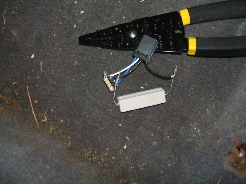

Step 6 make your circuit that looks like this but with better soldering and then attach it to the old o2 sensor wires. *Caution this is no joke the resistor for the heater element MUST be at least 12 watts and keep it the fuck away from anything that catches on fire..
http://i83.photobucket.com/albums/j294/steviekallday/2007_0103Image0013.jpg

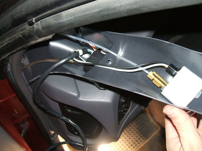

Step 7 Run wires under carpet and up behind everything to your sexy |A-Pillar gauge where you mount your sweet new gauge...But which faceplate (lifes soo hard sometimes)
http://i83.photobucket.com/albums/j294/steviekallday/2007_0103Image0014.jpg

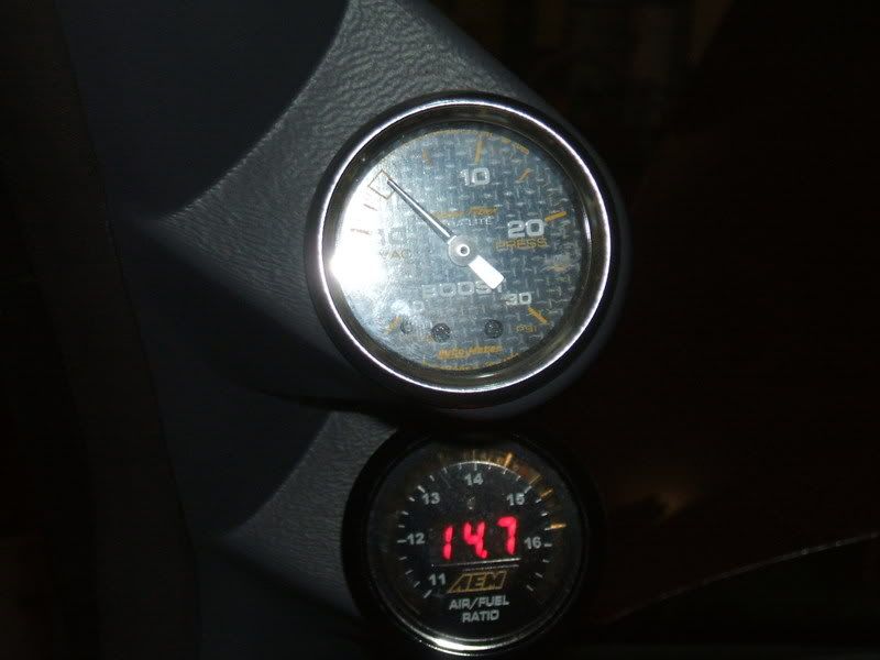

Step 10 ||(very important) get a sexy pic of your new gauges working with no CEL)
http://i83.photobucket.com/albums/j294/steviekallday/2007_0103Image0015.jpg
