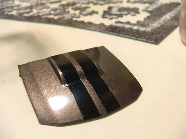

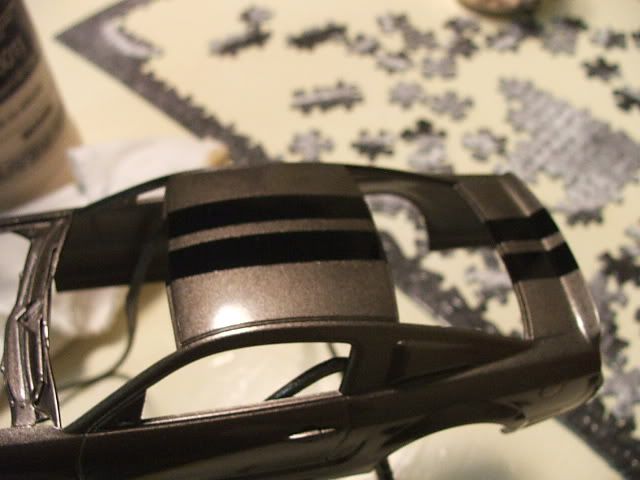

I painted the stripes on this car with no issues what so ever
http://i12.photobucket.com/albums/a218/black2002ls/06%20mustang%20eleanor/2005_1213Image0010.jpg
http://i12.photobucket.com/albums/a218/black2002ls/06%20mustang%20eleanor/2005_1213Image0007.jpg
