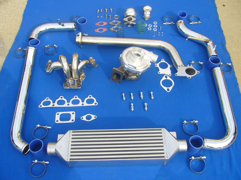

I forgot to mention that my one friend just gave me a stock turbo off a 91 Eagle Talon, since thats also a JDM Motor, would it bolt up to my D16Z6 if I got the intake manifold and the other stuff?
Where did I say to keep your car OBD0? You'd be better off converting to OBD1, IF you don't have experience with OBD0 tuning software and don't have access to a PR3.
As for the turbo, just because it came on a japanese vehicle doesn't make one difference. Actually, they didn't have Eagle talon's in Japan. That's an american made vehicle.
Anyway, you'd need a custom exhaust manifold, and then just custom piping/intercooler setup running to your intake manifold. I'm not going to go too far into detail on that, because there are thousands of threads on the matter already.

*EDIT*
Just found this on ebay, so Im going to save up for this also.
http://i14.photobucket.com/albums/a311/lenovm/P1020476.jpg (http://cgi.ebay.com/ebaymotors/Complete-Bolt-On-Honda-Civic-D-Series-D16-Turbo-Kit_W0QQcmdZViewItemQQcategoryZ33742QQihZ015QQitem Z250069668731QQrdZ1QQsspagenameZWDVW)
bambam89lx
01-07-2007, 10:14 PM
That looks like an xspower or ssautochrome turbo kit. Steer away from those as they include cheap parts. If you're going to go the turbo route, peace together your kit on piece at a time. Ebay is fine, just look out for the good stuff and it shouldn't cost you more than $1500.
As for your harness, it unhooks in the passenger and driver side of the rear engine bay. Then, it just gets unhooked from the engine. There's about 20 or so connectors that attach to the engine itself. It's a hell of alot easier to remove with the engine removed.
