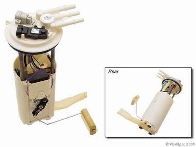

I agree fuel level sending unit. You have the option of replacing the complete fuel pump assembly or just the level sending unit <--cheaper. About 1.0 hours DIY.
Located behind the rear passenger seat in the trunk via an access panel.
http://i5.photobucket.com/albums/y186/lizzywiz/fpaccess.jpg
http://i5.photobucket.com/albums/y186/lizzywiz/fuelpump03.jpg
Pump Pump Assembly with Level Unit/Float

Not a bad suggestion but cleaning the contacts very seldom works or may only work for a short period of time. Once the contacts at the float wiper are worn out the unit should be replaced. Otherwise, the job will have to be redone.
What alot of people don't realize is GM has a level sending unit/float kit that can be purchased and installed separately without having to purchase the complete fuel pump assembly which is expensive around $300 plus dollars. The kit is available for around $85.00.
