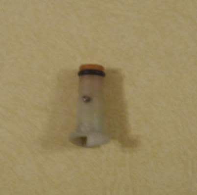

Hard to say. Possibly Dexcool sludge in which case you would need to flush the radiator and/or cooling system. You could drain coolant by removing the upper radiator hose where it connects to the bottom of the radiator. The screwdriver up the drain hole won't work. The housing being damaged could pose a problem if the drain plug doesn't lock down. It has the grooves the pin on the drain plug indexes to lock down. So it may leak. Here is a pic of the drain plug removed.

I don't believe AZ will have that part. It will be GM dealer only. In a worse case you may have to replace the radiator.

You can check with Autozone but I'm quite sure it is dealer only. Or maybe you can get one off a radiator at a salvage yard. Alero, Grand Am and Malibu are all the same.
