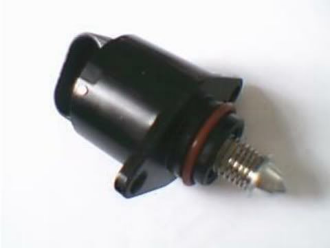

Best thiing is to try and clean it and the port in sits in up inside the intake.
Dont push or turn the tip/end of the IAC. It will knock it out of calibration, resulting in a worse idle or no start.
They arent cheap :grinno:
here is a pic of that IAC.
IAC (http://i28.photobucket.com/albums/c242/xeroinfinity/auto%20odds-ends/IAC.jpg)
If that doesnt work, I can locate a testing procedure.
