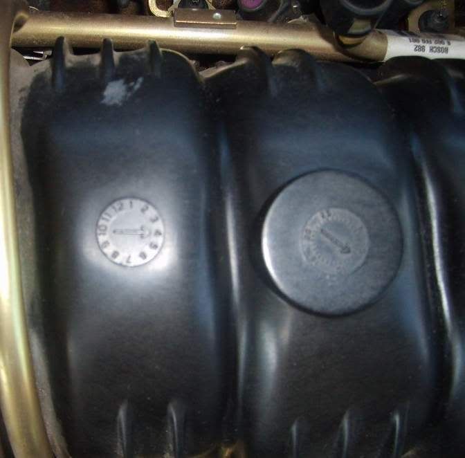

Is the date located on the dials the actual manufacturing date of the UIM itself or what? The question I have is why does the date coincide with the month and year the car was manufactured or so called built date which is when an engine is fitted into a car on the production floor at the factory/plant?
I thought I was seeing things when I saw the coincidence. This is a reply from one of our AF Advisors that owns a '99 Grand Prix GT with SII 3800 located in South Dakota. Original UIM. Notice the UIM date closely tracks the car manufacturing date.
My UIM is 6,16,99
Car is 06/99
Anyways, for anyone that wants the most current UIM offered by GM here is the part number for the kit, 89017272 and gasket, 89017554. This is the revised gasket introduced in spring of 2004 because '99 and up SII 3800s were supposedly still experiencing problems with coolant loss even with a revised UIM.
However, due to cost and the better specs I'd take the Dorman's version of the UIM versus GMs. Dorman UIM kits come complete with everything needed for around $120.00.
Pics '99 Regal LS SII 3800, Original UIM
http://i5.photobucket.com/albums/y186/lizzywiz/uim_left.jpg
Left (Month) & Middle (Day) Dials - 4, 7
http://i5.photobucket.com/albums/y186/lizzywiz/uim_right.jpg
Right Dial (Year) 99
