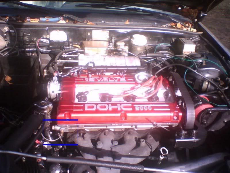

Mikelb
12-20-2006, 01:03 PM
Here's a pic of where mine is plumbed (ignore how crappy it looks, I am still putting the car back together)
and sry for pic quality... it was too bright outside and that was a camera phone

I have never seen anyone tap there oil line there on the 420a motor. I have finished my restrictor. Its a little piece of metal that fit inside the turbo, i put a spring in there also so that the plate would stay down. I heated up the metal and used a needle to make the hole. Its about 1/2 the size of the one in the turbo. How will I know if I'm not getting enough oil?
Mikelb
12-20-2006, 02:59 PM
sry, I forgot we were talking a/b a 420A... that's the stock location for a 1G-4g63...
Ok, from what I've read, no more than 15 psi at idle, I'd say anywhere from 5-12(15 on the high side) and you'd be good...
I have viewed a few peoples' sites, and they all seem to suggest a fitting with a .04, .06, or a .08 diameter hole... I'd play around with those... see what you get...
As far as high boost oil pressure, I'm not certain what it should be, but I wouldn't figure anything over say 25-30?!?
