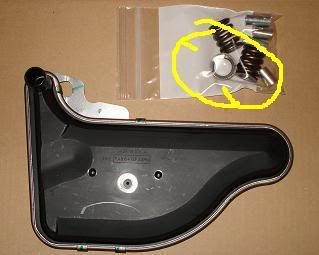

when intstalling a shift kit from the W-body store is required to have the new trans filter retaining sleeve put on. or can i re-use the old one. the retaining sleeve appears to be missing.
all that i have is
2 springs
1 filter
4 silver spacers( 1 bigger then the other 3)
thanks

The screen filter bushing is also a seal. Best thing to do is inspect it. If it looks good and the filter feels snug when you install it then resuse the old one. I recall the bushing/seal comes with the AC Delco screen filter kits but I guess the place you got it from left it out or decided it wasn't needed.

so the retaining sleeve is not a spacer or anything its a seal? and what if the seal breaks upon removal..just head to ace hardware and buy a rubber washer or what? i got the shift kit from a friend and he swore everything was there but directions(which were found on W-body.com)

heres a picture the circled item is what i DONT have
http://i80.photobucket.com/albums/j170/96talt1/wbsshiftkit.jpg
http://i80.photobucket.com/albums/j170/96talt1/wbsshiftkit2.jpg

Yup. thats it. I have a spare AC Delco screen filter kit (TF304) and it has the same bushing/seal in it. If you still have the old one installed in your tranny then I would reuse it if it looks good. I've done it with no problems.

If the seal holds the filter up when you install it leave it if it falls back out replace it. Just make sure their are no nicks in the seal
