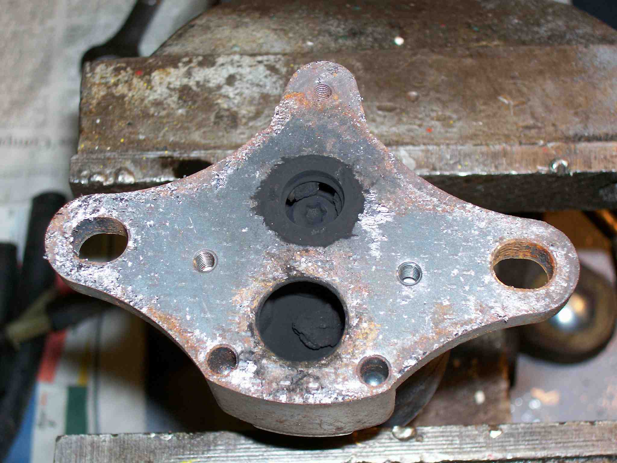

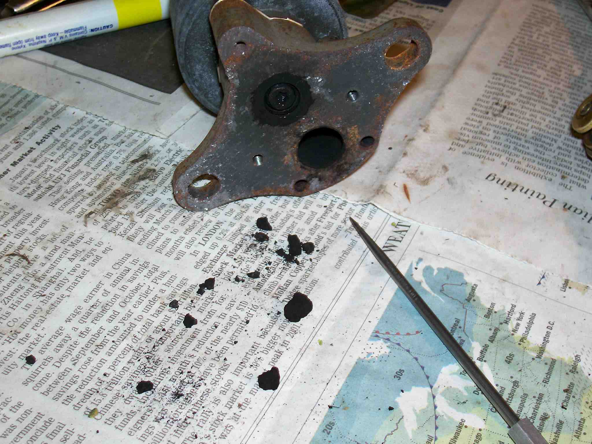

Another thing that you can check for is carbon chunks in the EGR valve. If you find them, the valve can be cleaned and doesn't need to be replaced.

One more thing, what is the EGR valve? How do I check it?

That is the EGR port. With the upper plenum removed, you should remove the EGR valve and check it. There is likely just as much carbon and coke in the valve, possibly holding it open - Creating a massive internal vacuum leak. Look closely and you'll see that this one (oddly enough, from a '95 VIN W Blazer) is stuck open:
http://www.wwdsltd.com/files/EGRValvePintleStuck262V6W.jpg
There is also likely just as much buildup in the exhaust feed port, so clean out the valve and both ports as best you can. A piece of stiff wire (coat hanger) can be used to reach into the ports and ream out all the loose carbon, then an air hose or shop vacuum can be used to get it all out. Do NOT use any cleaning chemicals on the EGR valve, just scrape off all the carbon until the valve pintle can seal fully against the seat.
http://www.wwdsltd.com/files/EGRValvePintleCarbon262V6W.jpg
Again, check the fuel pressure BEFORE you install the upper plenum so you can see exactly what's happening in there.
