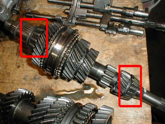

^looking back at earlier posts... I realized you have a 420A... oops, I was talking a/b the F5M33 transmissions... so, in your case... 1st might be synchroed, but with the car "jumping" forward, I'm assuming something is wrong with the clutch or disengagement...
After listening to the video (which I never did in the beginning), I'm gonna say the transmission has some serious internal issues...I don't know what that would be... possibly some sort of bearings?!?...
I wouldn't assume it was synchros b/c the car isn't going anywhere or isn't going into gear...
I wouldn't assume the differential bearings b/c the wheels aren't turning
I would assume it's something on the input shaft, since the car's in neutral...
possibly the input shaft bearings?!?
Here's a breakdown of what might happen, and shows most of the parts (this is for the F5M33, but I'm assuming the 420a tranny has similar)

Ok, here's a pic, outlining the input shaft bearings (from an F5M33)... This is what I believe might be causing the problem...
http://i34.photobucket.com/albums/d127/MikelBolton/Car%20parts/inputshaft.jpg
The reason I believe it to be them, is when the car is in neutral, no gears are engaged (shouldn't be synchros or gears), but the input shaft keeps spinning, so these bearings are constantly being used... With that many miles, it's possible that these are worn
