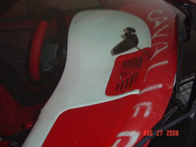

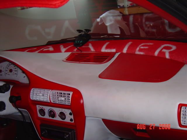

Derk_eliso
12-05-2006, 10:57 PM
yeah mine cracked too, I bought that vinyl repair kit, and it looked horrible, so what I did instead was measure and cut a piece of fabric (fleece) and I sprayed it with adhesive and streched the fleece around it. Beforewords I stenciled cavalier into it b/c I thought I was cool, lol. turned out alright. not bad for no experiance with fabrication.
http://i15.photobucket.com/albums/a386/Derk_eliso/DSC00459.jpg
http://i15.photobucket.com/albums/a386/Derk_eliso/DSC00460.jpg
