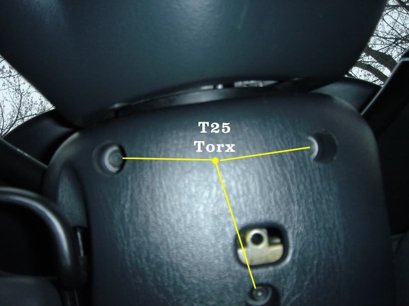

But to remove the multifunction switches you need to remove the plastic covers behind the steering wheel(which is out lined in the Disassembly procedures) its easy to remove.
Thiers Three(3) #T25 torx screws on the under side of the column piece (http://i28.photobucket.com/albums/c242/xeroinfinity/11X17RW24/St-colmcovr.jpg)behind the steering wheel.
Once removed the two halves pull apart like a clam shell(kinda). The top part will come right off, the bottom is tricky because of the tilt lever.
The MF switch is held in with one screw right on top in the center, carefully disconnect the electrical connectors as you pull the switch out/off.
