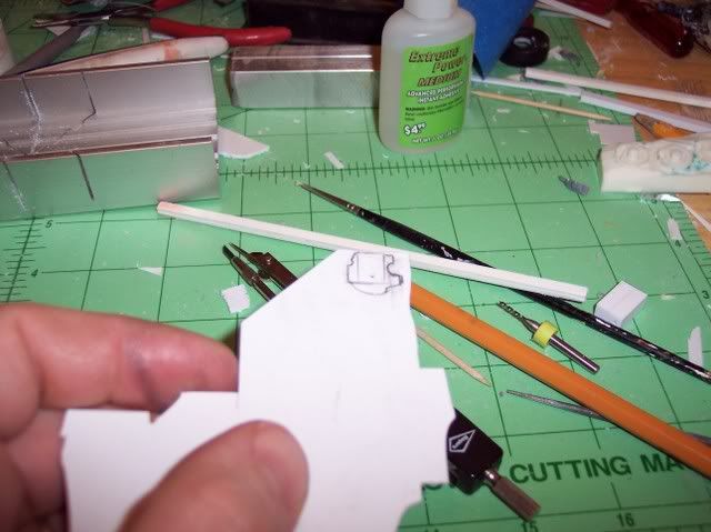

here's the rough sketch on sheet plastic for the bell housing mounting surface ready to be cut out and shaped.
http://i108.photobucket.com/albums/n4/rsxse240/model%20stuff/100_1816.jpg

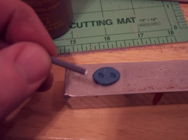

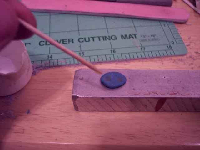

so I pressed it into some clay that is safe for RTV mold making to form a negative shape. I needed to make 2 of these that are identical so I made 2 temporary molds in the clay
http://i108.photobucket.com/albums/n4/rsxse240/model%20stuff/100_1818.jpg

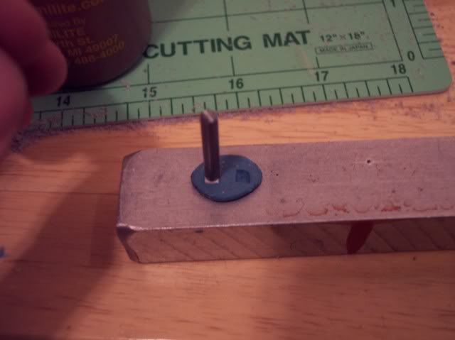

and again with the form pulled out
http://i108.photobucket.com/albums/n4/rsxse240/model%20stuff/100_1819.jpg

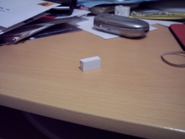

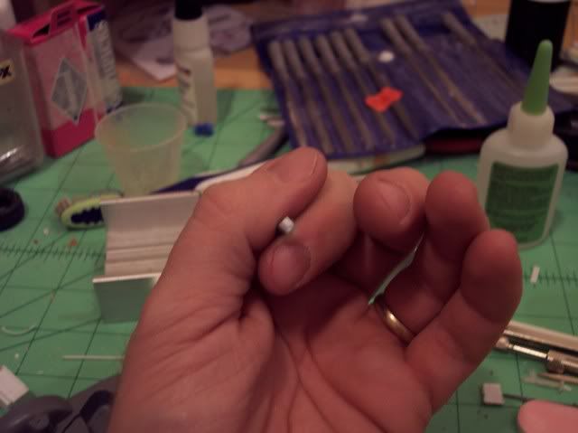

since these are such small parts I only needed like 2 drops of resin to make the parts, I just used a tooth pick to fill, then scrape the exess off so I have as little clean up as necessary
http://i108.photobucket.com/albums/n4/rsxse240/model%20stuff/100_1820.jpg
and here they are on the side of the block with the trans mounting surface and some other strips of plastic glued to the "block".
http://i108.photobucket.com/albums/n4/rsxse240/model%20stuff/100_1822.jpg
