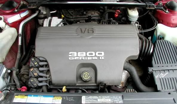

Here is a pic from a '96 LeSabre engine compartment:

I just bought a 96 Park Ave and it has that Cover on the engine that says " 3800 series II, i was almost shocked and thought it was a supercharged engine but no to my dispair it wasn't :cwm27:

I dont have one of those engine covers. but i am pertty sure it is a SII. My car was bought used a year ago with 95K, i'm cant tell if its had an engine swap, but the carfax report said it had only 2 previous owners with a rearend wreck. I raced a 05 SII , and tied all the way down the road, but my tires were balled and way out of alignment. Im going to race again to see if an alignment makes a diffrence.

Hey I am the one from Missouri.....lol. A pic of the engine compartment and VIN number would convince me. All I've ever seen in real life are VIN "L" for 1995. That include a 95 LeSabre I rented back in 1995 at Disneyworld (Orlando, FL).
