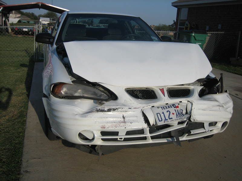

I was hit in my 96 GA, front pass side damage, and college student + not alot of cash= no collision insurance....
Thinking about parting it out, anyone interested?
96GA GT 2DR black, 136,000km
new tires, just changed oil , and trans fluid/filter i did last year,
Well taken care of,

that doesnt look to bad, is it drivable?
that passenger tire/wheel looks a little off :disappoin

From the picture, I'd guess you need a fender, strut and knuckle, and possibly a tie rod. Doesn't look all that bad, and the front struts are easy to bend when hit that way so it doesn't twist the strut tower around. Measure the distance between the top of the struts, compare it to another car and I'm guessing its going to be straight. I'd fix the car, even if you are going to sell it, that way you will get more for it. Good luck, parts are out there.

Nah it doesnt look that bad, at first anyways, upon closer inspection, the core support on the front end is bent, as well as the upper engine mount, tie rod end isnt badly damaged, but the rack and pinion is toast, same with the strut and lower control arm,im just worried that if i tried to fix it , that it would never drive straight again
plus who's gonna wanna buy a car that was in a decently not good accident?
so I don't know, should i Fix it or part it out?

It does look like it needs to goto the frame alignment shop :grinyes:
That right side would all need to be replaced,
as for cost of repairs $1500-2500.

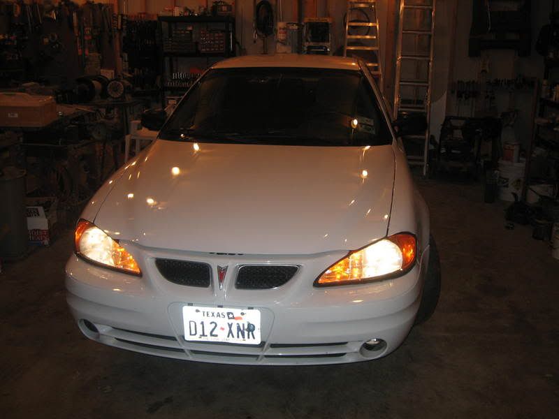

I wrecked mine last september
http://i23.photobucket.com/albums/b388/jfp43/IMG_0826.jpg
700$ later and a lilttle work(minus the airbags and windshield) and it looks like this
http://i23.photobucket.com/albums/b388/jfp43/IMG_0963.jpg
http://i23.photobucket.com/albums/b388/jfp43/IMG_0962.jpg
