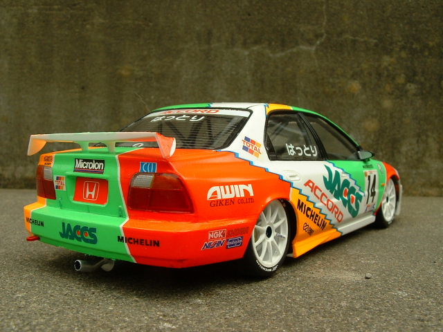

This model here would have to be the worse model for being a decal nightmare :(
The car is sprayed white and everything else is decals
The bumpers used SET and a hair drier and turned out pretty well.
PS...Jay...these pics are just for you as you like them on my steps !!......i kinda agree with you to...lol
