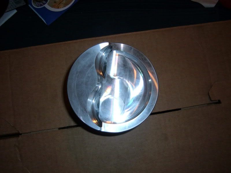

My thanks goes out to Lloyd from Springfield Custom Auto Machine.
http://s116.photobucket.com/albums/o19/1BadS10Xtreme/Engine%20Rebuild/
A little preview.
http://i116.photobucket.com/albums/o19/1BadS10Xtreme/Engine%20Rebuild/DSCF0234.jpg
http://i116.photobucket.com/albums/o19/1BadS10Xtreme/Engine%20Rebuild/DSCF0254.jpg
All that has been done to the 4.3L:
Engine Balanced
Bore .30 over
Polished crankshaft
new cam bearings
Eagle H-Beam rods
Keith Black pistons, 8.7:1 compression
new rod bearings
new main bearings
Comp Cam 270AHR. Duration: 270 in., 276 ex.
PBM Valve Springs
I've pulled this thing apart and put it together once already, but that was while it was still inside the truck. This time around it should be a lot easier with the engine hoist.
