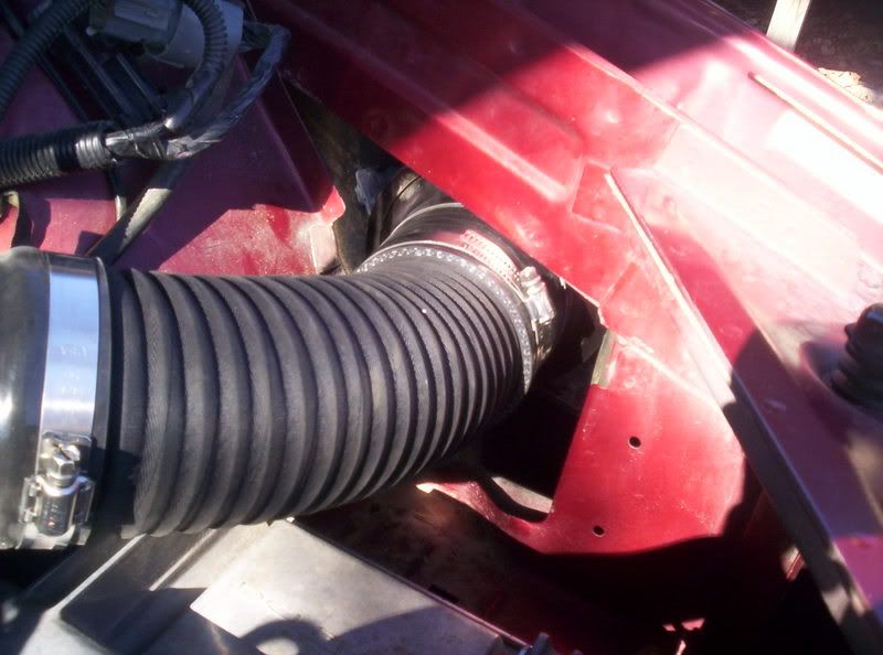

I finally got everything I need to build my own.
Parts used were as folows:
AEM DryFlow filter 3.5" OD neck
Intense Racing 3.5" tubing and TB adapter with IAT hole, meant for the 3800, but modified to work with my IAT sensor.
3.75" Silicone coupler after finding out that two pieces that both have a 3.5' OD will not fit together :oops:
A small piece of rubbery/plastic flooring type material...I used it to patch up a hole on the splashguard material that would allow water and grit to splash up into the filter.
Total cost was slightly less than 150 bucks, not sure on the exact figure, and some of the cost couldve been elimnated had I ordered the right stuff the first time around.
http://img.photobucket.com/albums/v78/LittleHoov/100_1446.jpg
http://img.photobucket.com/albums/v78/LittleHoov/100_1447.jpg
http://img.photobucket.com/albums/v78/LittleHoov/100_1448.jpg

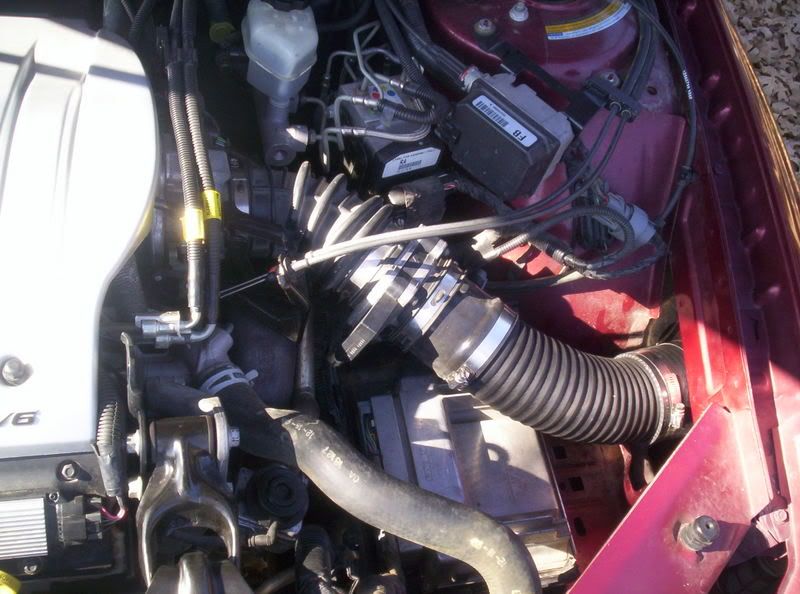

The PCM sits in the stock location, using whats left of the stock airbox, I cut away a large portion of it, keeping only enough to securely hold the PCM in the stock locale.
http://img.photobucket.com/albums/v78/LittleHoov/100_1449.jpg

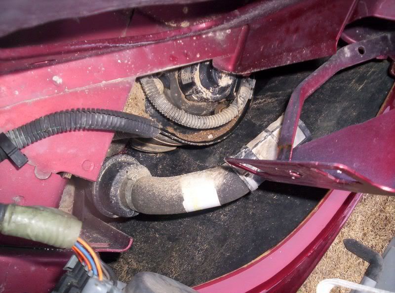

The hole in the fenderwell had to be modified slightly to allow the filter to slip through, it still barely fit through, but fits fine once it gets in there.
Ive been running a Short Ram setup for quite a while, and I seemed to notice even still more throttle response from the brief test drive I took. Sound is different from that setup but I think I like it better.
Im starting to feel that the PCM is holding it back quite a bit, because when you step on the gas from a roll the engine revs almost instantly, but theres still a noticeable lag before it downshifts and takes off.
Just thought Id share!

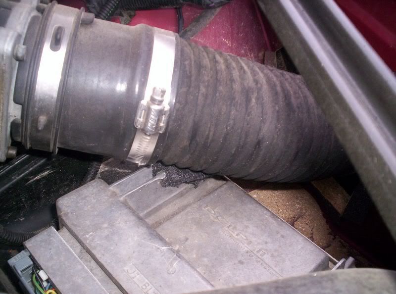

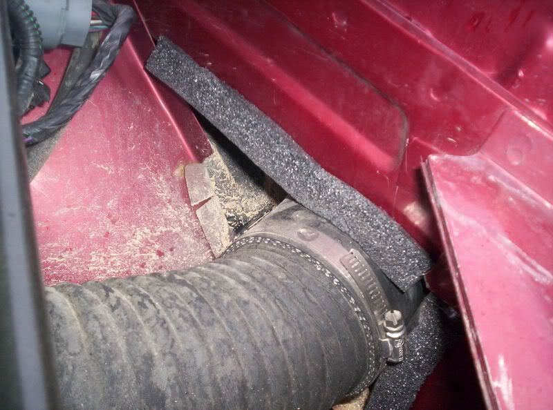

Okay I ran out in the rain and snapped a couple pics before I gotta leave.
These first two just kinda show the black stuff I used, I didnt use it for insulation from engine bay heat, I used it to dampen the vibrations the intake setup was causing, keep in mind that under WOT that intake is going to be twisted as the engine twists back towards the firewall, so it was contacting bare metal and making vibrations and not cool noises, that stuff seems to have cut back on that dramatically though. The ridges on the PCM were actually starting to cut into the tubing a little, I could see the metal from the springs inside. That has stopped as well.
http://img.photobucket.com/albums/v78/LittleHoov/computer/100_1631.jpg
http://img.photobucket.com/albums/v78/LittleHoov/computer/100_1632.jpg
