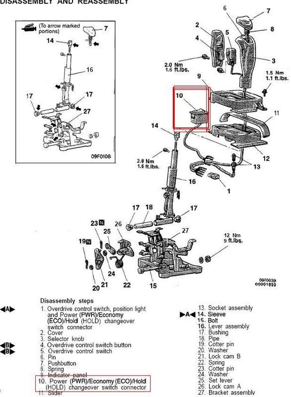

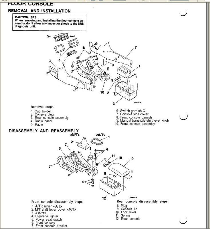

thats been the issue... but i just can't seem to get the middle console out... basically, what i really need is to get the whole shift column out of it (it's an AT) so if there is anyone who's actually pulled that out, I'd like to know how they did it... :)
Linebckr49
12-02-2006, 06:36 PM
these pictures should reveal more than you need to know. honestly, it appears that you can just pop the switch out w/o removing the entire console. but its up to you. seriously, if you still can't figure out how to remove the console, ask a friend to help.
