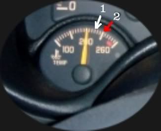

The fan #1 comes on @ 220 deg.
Fan #1+#2 comes on at 240, or when your AC unit is on, both will run.
Dex gets that extra 10 degs with a type a sodium molecularly bonded to the glyco atoms.
dont ask how I know this:grinno:
My SE is full sythetic(w/dex too), no problems for over a year. My GT has Green prestone it runs fine and no problems with the temps anymore.
Though, I am running a 180 thermostat to keep those temps way under the usuall 200 deg running temperature.
here is a pic of the gauge 1 is fan one.
2 would be the temp where both fans should run.

I'm not real sure just how hot it is getting but when it gets A little above the normal line is when it blows the water out.
