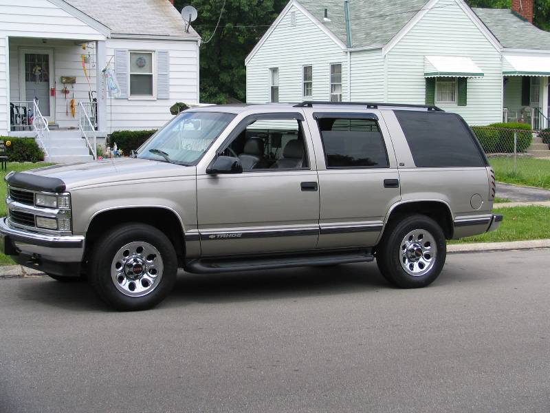

A shot of the ole girl : ) http://www.trcdtoys.com/Wheels/slides/Tahoe%20007.jpg
