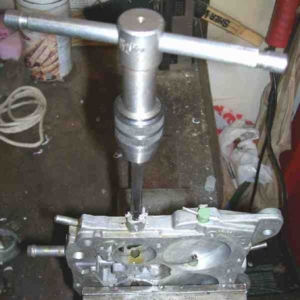

Discarding an otherwise serviceable carburetor because of a worn throttle shaft seems silly when it's so easy to repair the problem:
Remove the throttle plates and shaft, mount the throttle body in a vise, and ream the worn guides straight for a bronze bushing:
http://www.wwdsltd.com/files/4MVThrottleGuideReam.jpg

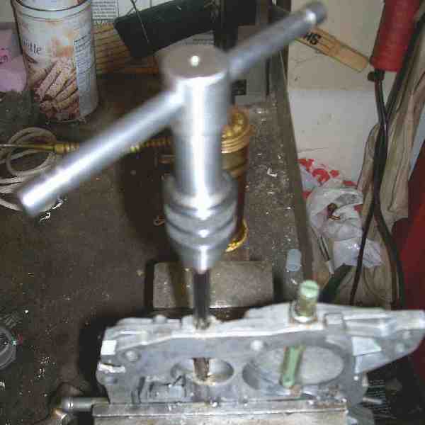

You only need to bush the two outers, since any leakage at the center is not a problem. Make sure you've reamed deeply enough to accomodate the full bushing length:
http://www.wwdsltd.com/files/4MVThrottleReamDepthCheck.jpg

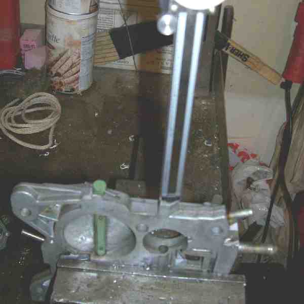

Clean up your chips and oil the throttle body and bushing. Mount the bushing on the installation driver and drive it flush:
http://www.wwdsltd.com/files/4MVThrottleBushingDriver.jpg

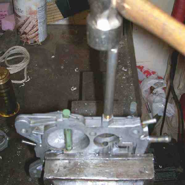

If the bushing is not fully flush, file the end so it is not beyond the throttle body casting. Ream it to the final finish size and to achieve proper shaft alignment:
http://www.wwdsltd.com/files/4MVThrottleBushingFinishReam.jpg
Clean up the chips and assemble the throttle shaft and plates, makign sure the plates are centered in the bores as you tighten their screws.
Easy enough?
