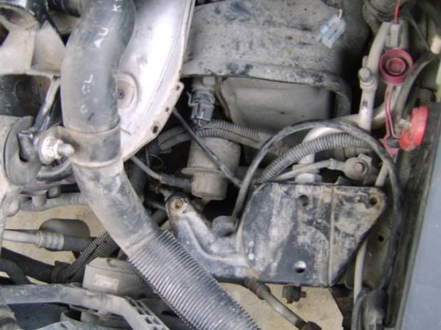

Well. I went and i took a look. According to a manual, this is it
http://i28.photobucket.com/albums/c216/timpropeg/vacuummodulator.jpg
just a picture i snapped of it. Its in the middle of the picture. I felt around the hose and it didnt have any cracks in it at all. Could the modulator itself be shot?
Also. Before I took the airbox and stuff off (i know you dont have to do that to get at it, I just wanted more room) i had taken it for a ride. And it seems it just didnt want to shift out of first. After i was poking around down there, i unhooked the connector above it, and made sure it was on properly, etc. I took it for another ride. When accellerating slow, it seemed to shift fine into 2nd (just a little late i would think because the rpms were a little high) and when i got to 44km/s, the engine revved up and acted as if the car was in neutral. i floored it a few times, and it eventually started going again. And I also found that if you floor it while accelerating, it doesnt act like it's in neutral like when you are accelerating slower.
Sorry if some things arent explained well, I tried to do it the best i could without trying to confuse anyone hehe.
Also, my father seems to think it may have something to do with the governor. Could that also be a thing to check?

When you pull the vacuum hose off the modulator do you have good vacuum? This starting to sound like an internal problem, Next step may be a scan of the trans functions at a trans shop or dealer. Is the fluid burnt?

You did identify the vac modulator in the picture correctly. You should really check that line all the way up to the intake manifold. By the look of it, you should replace it anyway.
