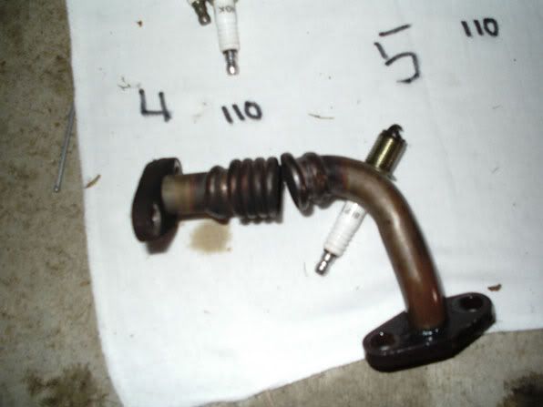

A) I never recommend changing to anything new when trying to pinpoint a problem. Why add something to the equation. I can't really see how the EGR system would be causing your stalling. I mean even if the valve was stuck open all the time, it normally is open at idle anyway (I believe...it should only close at full throttle), so that wouldn't make a difference. So unless you have some huge plenum leak in hte EGR pipe or something (which would be easy to find via pressure test)
Something like this:
http://i55.photobucket.com/albums/g134/jcr5186/egr-pipe.jpg
...I don't see it being the problem. Speaking of which, have you pressure tested???
