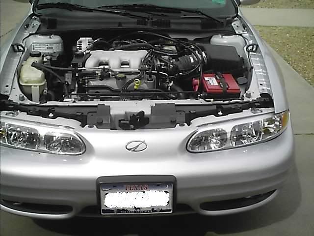

The cost for the radiator drain plug doesn't sound right. And the cost the GM dealer gave you for repairs is too high. You can get a GM or aftermarket radiator alot cheaper. Replacement of the radiator will require removal of portions of the front clip and any parts like the shroud that will be in the way.

it's pretty tricky getting it out with that ac condensor in the way, wear gloves :grinyes:

It sure is JC. Proof is in the pudding. See pic below.

BTW - Here is the after work completed pic.

Damn Bob !
I have taken them out without removing the whole front clip,
thats alot of work just for a radiator :shakehed

The work wasn't just for a radiator. We had a new paint job done on the bumper skin and some other work. New plastic pieces, etc. Getting it ready for the cruel Northeast weather (New York). Weather and rust proofing. Just though I'd share some pics. But based on the way the Alero front end is designed you're better off removing what you can. Actually makes the job easier.
BTW - Forgot to mention we got the brand new radiator (OEM GM/AC Delco) off of EBay. Winning bid was $78.00. :grinyes:
