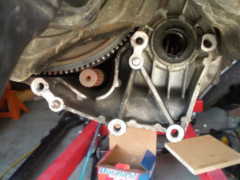

Ok so you got the top four im guessing
http://i39.photobucket.com/albums/e165/jason_bet/CIMG1156.jpg

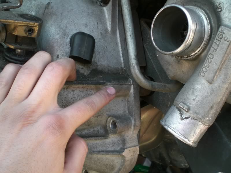

Then you got the one in the front behind the turbo you have to get a long extention and put it threw the bracket for the motor mount
http://i39.photobucket.com/albums/e165/jason_bet/CIMG1157.jpg

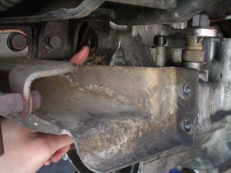

then you have the starter thay you need to pull and get those 2 bolts off and then there are two more bolts on a bracket right below that one
http://i39.photobucket.com/albums/e165/jason_bet/CIMG1158.jpg
Then you have your 5 bolts holding in your transfer case http://i39.photobucket.com/albums/e165/jason_bet/CIMG1159.jpg

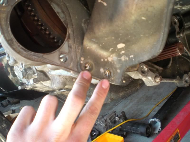

and then there are 3 more bolts two of them are on the bracket in the back and the last one you need and extention look at my finger
http://i39.photobucket.com/albums/e165/jason_bet/CIMG1160.jpg
I think that all of them
