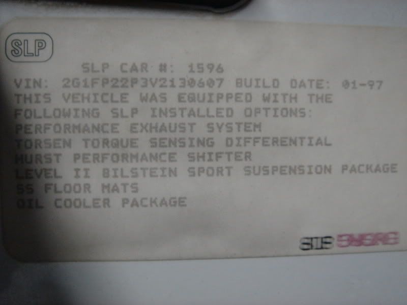

ikeyballz
11-14-2006, 06:01 AM
yeah, im pretty sure its a torsen diff, not only does it say that on the SS notebook.. but i have never been able to 'powerslide' it into turns like i used to be able to with my posi on the 3rd gen..
also ive been looking up the SS option on a bunch of camaros for sale, and most of them also list the torsen.. 'torque sensing differential'
ill take a picture of the SLP options on my door..i swear i had a picture on my desktop..
ikeyballz
11-16-2006, 03:08 AM
my bad for the late reply.. damn midterms are killing me..http://img.photobucket.com/albums/v132/ikeyballz/DSC01904.jpg
