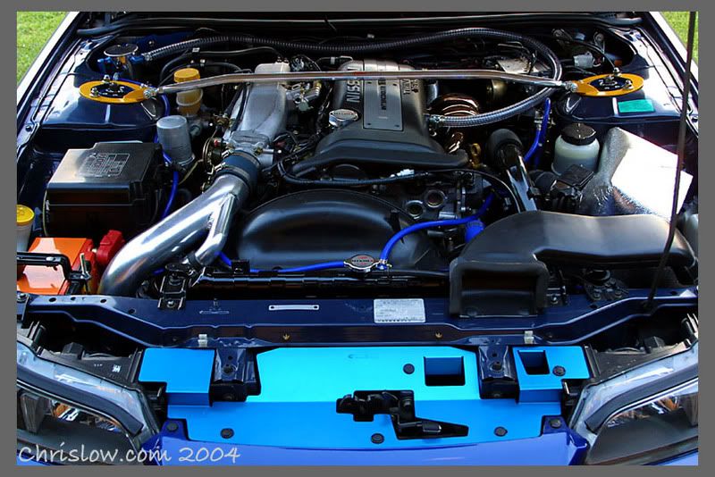

currently im working on a S15 and i have a sr20det for it! can u point out the parts in the engine for me pls so i can work from that and can u tel me were i need to install wires?? pls that would be great! here is a pic for it thnx!
http://i15.photobucket.com/albums/a358/anopanjo/engine_bay.jpg

On the SR20 engine, the plug wires are hidden under the cover in the middle, so you can't see it. But you can add other details like brake and fuel lines, etc. And I think those blue lines are for grounding, and they add a touch of performance-oriented look.

It really is all about good reference pictures. And honestly, the limit is how far overboard you want to go. For hoses, in that S15 for example, you could go absolutely crazy getting all of them, and it'd end up looking pretty cluttered IMO, so unless you're going for a 100% stock buildup for a show, I would just stick to the major stuff. Here's what I usually add to my engine bays (granted, usually American musclecars...)
1. Battery and battery wiring
2. Any and all underhood stickers (emmissions, engine info, belt routing)
3. plug wires (this is a given--get a pin vise set so you can drill out their locations--as mentioned though, the ones on the S15 are hidden anyway)
4. Heater hoses. Unless it's a racecar, it should have a couple of hoses off the heater core running to the side of the water pump area. Same goes for A/C hoses. I use either Detail Master hoses, or I use .062" solder, and paint it flat black.
5. Hose clamps. You can either paint a very thin line around the hoses where they enter and exit the engine and rad, or you can use really small gauge bare wire, and twist it around it.
6. Blackwash. On any parts of the engine that are supposed to be bare steel or aluminum, I like to do a very light blackwash (that's about 80% thinner, 40% flat black mixed together) to give it a feeling of depth, and also light road grime to make it look realistic.
7. Carb linkage. Assuming it has carbs.
8. Brake lines. Just off the master cylinder. Unless I'm doing seriously detailed work, I don't run the brake lines throughout the whole car, but I do run them, curled around a pin (to give them the spiral shape) off of the master cylinder, down and then under the firewall. Really helps the master cylinder stand out. I also run a hose or solder off of the brake booster to the intake manifold, if it has power brakes.
9. Paint the small raised details that some firewalls have with a series of metal and black shades to make them stand out.
Those are just some suggestions. As I said you can get far more detailed, but keep in mind that the more stuff you cram in there, the more it tends to take away from the beauty of it all. Here's a couple examples of my engine bays--bear in mind, I don't always do all the things I listed:
