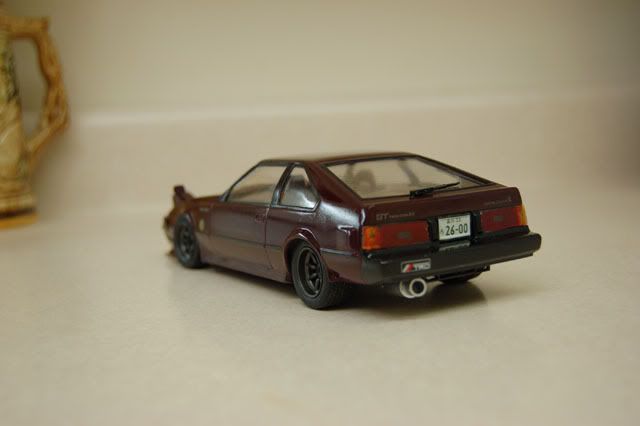

Well I used this combination, for some reason the paint turned out with a lot of orange peel. I layed down heavy nice coats, and when it was wet, it was an eye catcher, after 10 min of drying it changed. I was wondering if something occured when I mixed different brands. Please let me know what I did wrong.
sample pic
http://i21.photobucket.com/albums/b276/orbitronio/DSC_0015-2.jpg
hard to tell, but you can see a little bit, much worse in real life.
sample pic

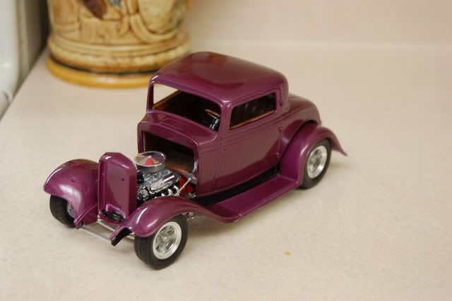

Vyacheslav
11-15-2006, 03:55 AM
Well I decided to give testors one more go. No polishing, just 2 coats of primer and 3 coats of paint, excelent result. Was done with testors purple metalic
http://i21.photobucket.com/albums/b276/orbitronio/DSC_0069-1.jpg
