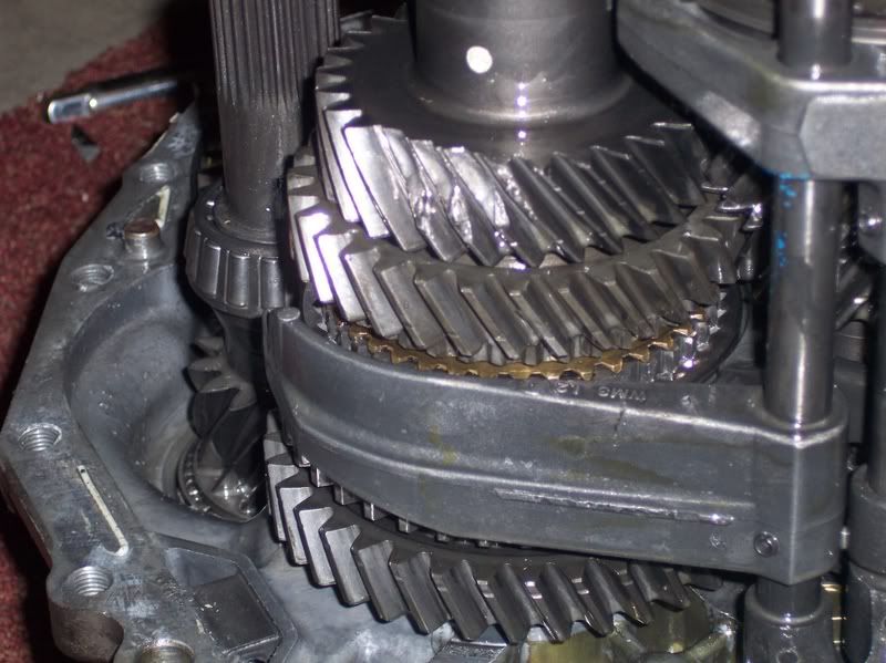

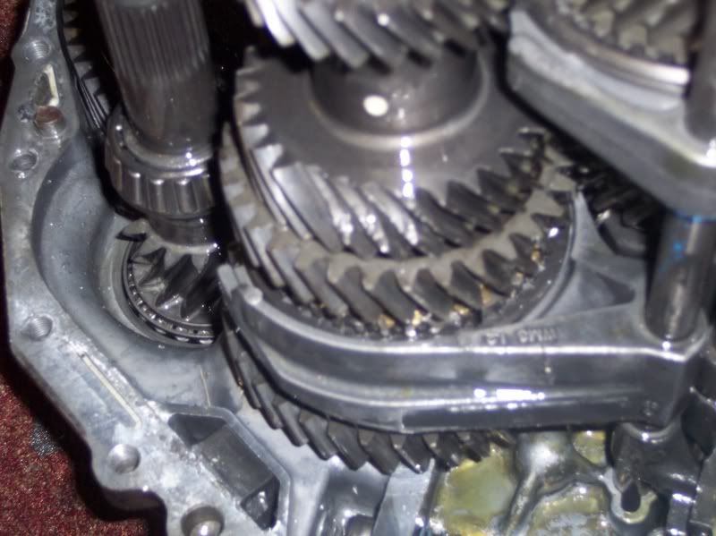

Heck yeah....there is a ton of stuff under my hood that are disgusting that I have noticed since pulling the motor....I am going to replace as much of it as I can....I have a fat hook up on stainless steel lines....hard and braided lines...but here are the pictures of my jacked up 3rd gear.....I couldnt get a good shot of the other gear but this is bad enough...

Damn... glad that you found the problem though... get those metal chunks outta the transmission... might as well replace the synchros while you're in there... GL
